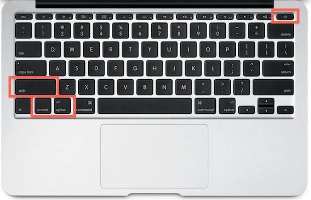

But then resetting the SMC seemed to do the trick. It's sleeping happily now, "breathing" convincingly, and cooling. Also, it's off the network. SMC reset seems to cure insomnia. Thanks!
This seems to be an understood problem and remedy.
Also, when you close the lid, it takes a minute or so for the sleep light (I understand it's actually called the "SIL" = sleep indicator light) to start doing its thing. Now it does.
Yes, that is the best first step, as the SMC controls several things replacted to power and sleep.
