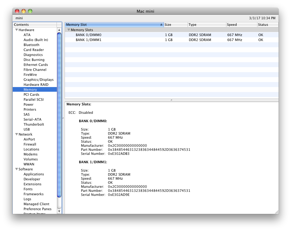

OK...in Snow Leopard:
About This Mac > More Info... > Hardware > Memory
It should show two banks - BANK 0/DIMM 0 and BANK 1/DIMM 1 along with the size of each. Since you purchased a 4 GB kit - 2x2 GB, it should show both slots occupied with 2 GB DIMMs. If you see both slots occupied with 1 GB sticks, then the kit may have had the wrong DIMMs in it.
Here is what one of my Mac minis running Snow Leopard shows:
If you don't see that, and have tried switching the sticks and it shows the same, then one of the slots is bad. Both sticks could have failed at the same time, but not normally. I have seen slots fail, but normally due to some form of liquid/physical or static damage. In a few rare cases, the logic board/RAM slot failed, but only once or twice that I have seen.
Hope that helps,
