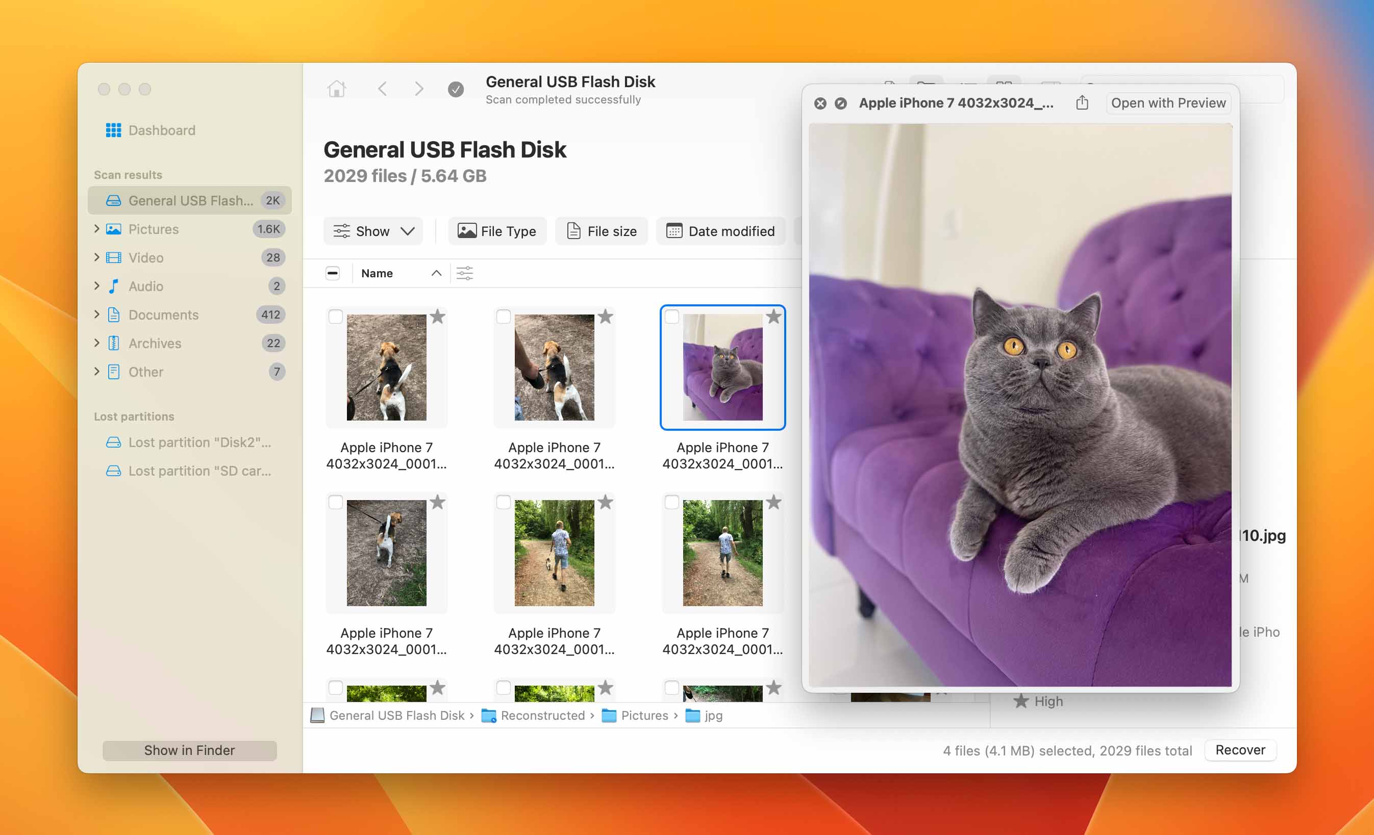

OK, had some time to get back to this. This link is useful:
From what I have seen and read, Disk Drill is the best. You can start by using the free version to do a comprehensive scan of the "problematic" SSD. But to actually recover the information, it looks like you'll need to purchase Disk Drill, for $89:
There is a "media only" version available in the App Store, for $39.99:
But that can only recover media-related files, etc.
If you decide to pay for Disk Drill, do a google search first for reviews of it. That could provide valuable information.
