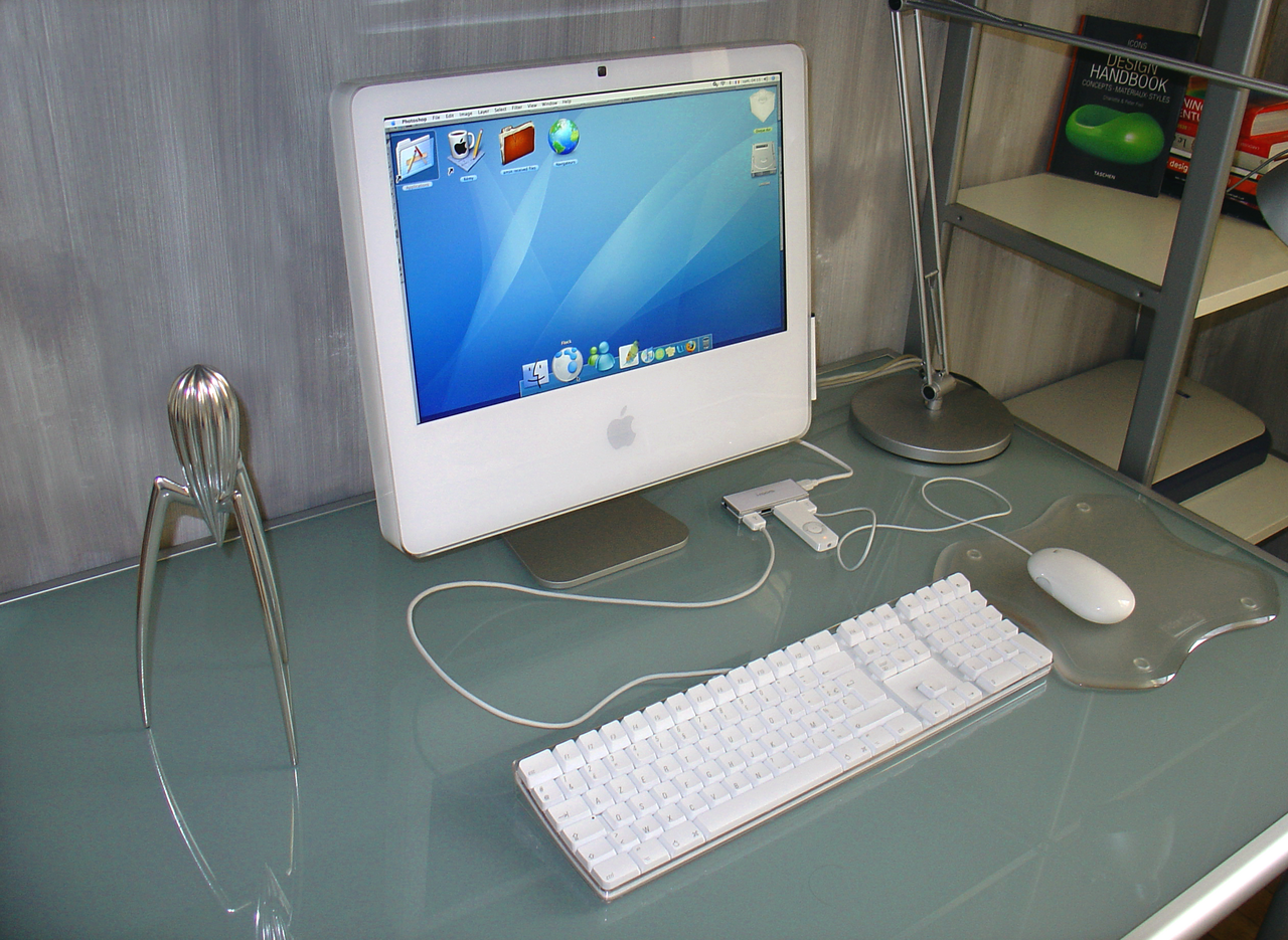

There isn't a disc release hole for a paper clip near the power cord jack that I recall, so I am not sure where you got that information?
I assume your have a white polycarbonate iMac like this:
Any standard AC power cord will work:
These are standard power cords that come with a variety of electronics - TVs, PCs, computer monitors, electronics, etc. You can find them online for $3-10.
