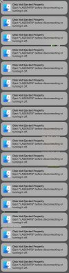

Which external drive does not cause the "Disk Not Ejected Properly" error? (MacMini M2)
Jul 23, 2023
What is your reliable external hard drive that does not eject when your MAC goes to sleep? Any recommendation welcomed!
I was ready to pull the plug on the OWC miniStack STX but then I read in comments that users get the "Disk Not Ejected Properly" error.
I tried a lot of things but constantly get the error message that the "Disk Not Ejected Properly"
I don't look for a back-up drive but a reliable 'working' drive to edit my photos, videos & documents. (SSD or eNVM, doesn't need to be portable or rugged, just sits on my desk as a storage extension for my mac)

Basically the only times that I have seen this error is when the External Drive is connected via a Hub or Dock. Have you tried plugging the drive into one of the ports on your mini to see if the error goes away?

Yes. Always connected directly to the port on the Mac mini.

Personally, all, or maybe 99.99% of my experience with “Disk Not Ejected Properly” were connected to specific drive enclosures—hard drives and SSDs, ATA or NVMe. Not counting other factors like power outages or sheer stupidity, I’m confident that it is caused mainly by the enclosure hardware. For me, the only solution is to return the item if possible, or simply trash it.
From personal experience I would recommend getting a single NVMe enclosure (I have a couple… three, actually, one in reserve). I say get the Acasis tool-free NVMe enclosure. It recently was going for $99 on Amazon (thus my reason for having three) so you can wait if you can afford the wait. If you have the M2 Pro mini, you probably don’t need a Thunderbolt hub. If you have the non-Pro with two ports, you may have to invest in a good TB4 hub. I have the CalDigit Thunderbolt 4 Element Hub and perfectly happy with it. As for the SSD for it, I’m on my third Western Digital BLACK 4TB SN850X SSD. I’m sure the 2-TB will perform as well, capacity aside.
I don’t know if the case of your Mac mini gets hot. My intel Mac mini used to, and I had to have my bag of frozen peas ready to cool it down, but my Studio is absolutely room-temperature cool, so I use it as a heatsink for the external SSDs. That’s the main thing to worry about these cases since they don’t have active (fan) cooling. I use them principally as test beds for Monterey, Ventura, and Sonoma, plus other data that would benefit from the speed.
I also recommend, when you’re ready, upgrading to Sonoma. If you wish to stick with Ventura, I suggest updating to 13.6 but not to build 22G109! That was a disaster. Make sure it’s build 22G120. Enjoy!
