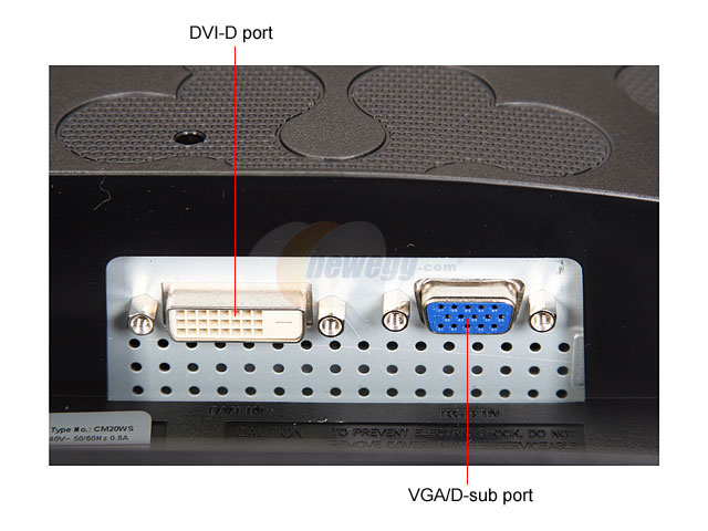

OK, thanks.
Looks like that model has a VGA and a DVI connection:
Your MacBook Pro has an HDMI and a Thunderbolt/Mini DisplayPort:
You can use either of these to connect with the appropriate VGA or DVI video cable:
Mini DisplayPort to VGA Adapter
Mini DisplayPort to DVI Adapter
Hope that helps.

Yep, thats what I am using. DVI-D on Samsung, into Thunderbolt on Mac.

-Maybe some of the controls only work with an analog VGA connection. Many digital inputs (DVI/HDMI) cannot be adjusted.
