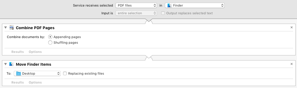

This is a much easier Automator Service workflow:
See if that works better for you.
May 18, 2018
Thanks Cory Cooper. You are right it is a much easier script and I realised what was wrong in mine thanks to yours. It was the "Get Selected Finder Items" which I was supposed to remove before to run the workflow outside of automator. The fact I did leave it was "duplicating" the files to combine hence the A-B-A-B instead of A-B. Many thanks!
Excellent...glad it worked for you. Thanks for explaining what the issue was in the original workflow, so that others may benefit in the future.
