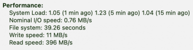

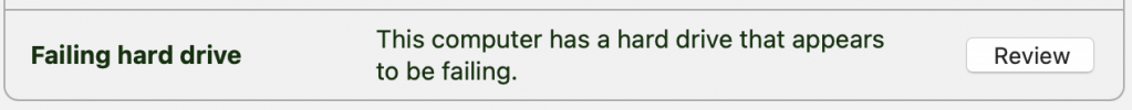

I believe you are on the money with potential hard drive fault. Based on another sites recommendation I ran EtreCheck Pro which has come back with:
Runtime: 5:02
Performance: Poor
Performance:
System Load: 1.05 (1 min ago) 1.23 (5 min ago) 1.04 (15 min ago)
Nominal I/O speed: 0.76 MB/s
File system: 39.26 seconds
Write speed: 11 MB/s
Read speed: 396 MB/s
Failing hard drive. The computer has a hard drive that appears to be failing.
Time for me to engage OWC in a conversation about testing their SSD and potential warranty claim.
