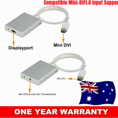

this looks like it’s got the right terminals, but says it won’t work on Thunderbolt- I’ve read a few items that says the same, others saying it will for video? Might be better off binning the old iMac.

Officially, the Apple Thunderbolt Display system requirements state: "Thunderbolt-enabled Mac computer, including MacBook Air, MacBook Pro, Mac mini, and iMac". I believe this requirement is because the Thunderbolt cable in the wiring harness (which also has a MagSafe connector to charge portable Macs) connects to a Thunderbolt port on a Thunderbolt-equipped Mac to carry audio/video/data between the Mac and the display's built-in FaceTime HD camera/mic, speakers, and ports. You can connect peripherals to the display's ports, and the Thunderbolt port on the back of the display can be used to connect another Thunderbolt display, storage device, etc.
Yes, Thunderbolt 1 connectors are the same physical connector as a Mini DisplayPort, but the wiring/internals are quite different, because Thunderbolt supports more than just video. Unfortunately, I don't think there will be any combination of adapters that will allow connection to the Mini-DVI port on the iMac.
