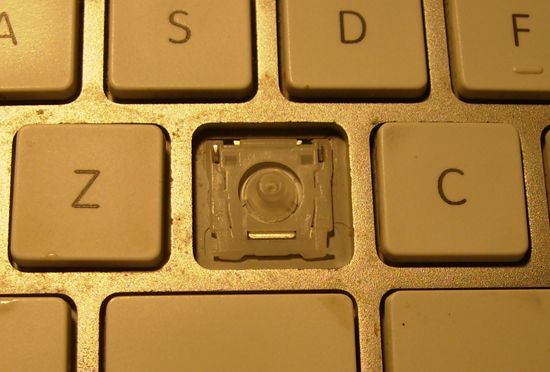

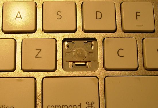

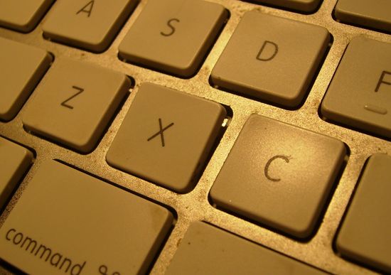

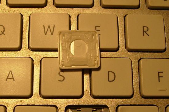

Right, I took a series of photos and I hope these help.
This is what happens if the bottom of the key is tapped.
The whole key comes out.
The clip stays attached to the key cap and has to be popped off to set back in the board.
So, while it's resting back in here, the top two clips aren't gripping it firmly. I can't pop it in and out, there's no tension in the clip to do so.
Hope these are of some help explaining what's going on.
