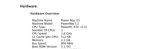

Power Mac G5
Machine Model: PowerMac7,2
I have attached a screen grab from the profile. Do you need more info for the G5 ?

Thanks for the additional information.
You are actually in a tough position, due to the hardware limitations of the G5. From memory, it can only be used with target disk mode via FireWire unfortunately. Officially, external optical drives need to be FireWire as well, which is why the USB drive you purchased isn't recognized. There are a few unofficial workarounds to startup from USB, but they require dealing with Open Firmware and don't work 100% of the time. Here is a thread on Apple Discussions about it:
