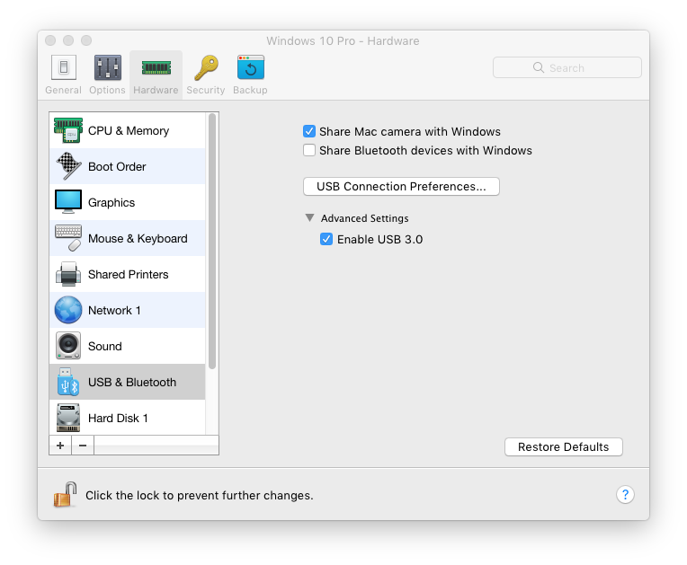

You could check the settings in Parallels for the Windows virtual machine you are running. Below are the settings mine is using:

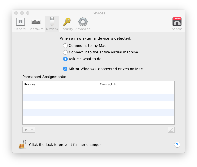

Click USB Connection Preferences... in the window above for the options below:

All set now.
The key was the "ask me what to do" box.
