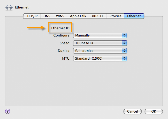

-Ethernet > Advanced network settings - is it set to Automatically or Manually? If Manually, what are the settings:
Ignore the orange box and arrow

Hello Cory and thanks again - sorry for the slight delay. Was waiting for my flat mate to help me a bit. OK, the hard drive is IBM Desktar 7200 RPM. Ethernet is set on automatic. Not sure what a cross over cable is - would you be patient enough to explain? My flat mate experimented by copying the Ethernet settings you show above but there was no change to the speed. Still hovers around 5 MBps.
No worries.
It is best to keep the Ethernet settings set to Automatically. That image just shows what it would look like if set to Manually, and I wanted you to list them if you had changed them.
