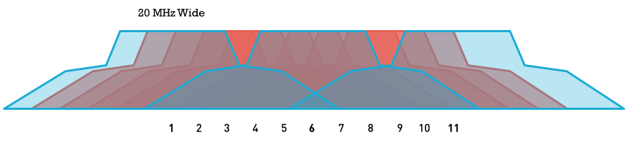

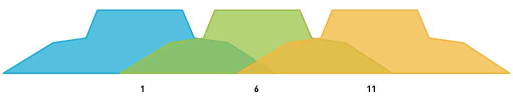

Non-Overlapping Channels
Each channel on the 2.4 GHz spectrum is 20 MHz wide. The channel centres are separated by 5 MHz, and the entire spectrum is only 100 MHz wide total. This means that the 11 channels have to squeeze into the 100 MHz available, and in the end, overlap.
However, there are three channels that don’t overlap: 1, 6 and 11, as you can see in the image below. Co-channel interference is where devices take turns talking, so the more devices on one channel, the longer it takes for a device to talk since it has to wait for its turn.
Armed with the above information, you’ve narrowed your selection down to three channel choices (1, 6 and 11) without using any software! I would try Channel 6 and see if this improves things.
