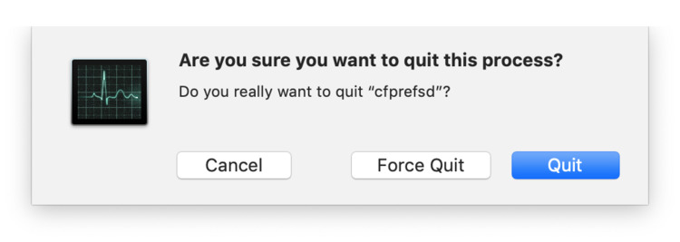

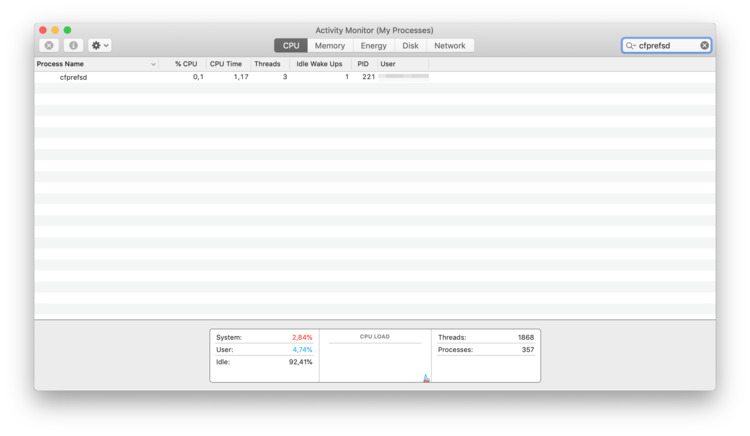

  • Run ’Activity Monitor’ app.
  • Using search tool, find the process cfprefsd.
Run Activity Monitor
  • Stop the process which is being run under the user (not the one run under root). To do so, click the process and then click X on the upper left. Confirm it in the dialogue window.
Confirm
