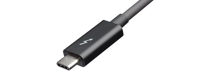

The Apple USB-C Charge Cable - (2 m) supports charging USB-C devices, and also supports USB 2 for syncing and data transfer between USB-C devices. I believe that is the one included with the current MacBook line, for use with the AC Power Adapter bricks. The Apple Thunderbolt 3 (USB‑C) Cable (0.8 m) is an actual Thunderbolt 3 USB-C cable, which supports Thunderbolt 3 data transfer up to 40 Gbps, USB 3.1 Gen 2 data transfer up to 10 Gbps, DisplayPort video output (HBR3), and charging up to 100W. Note the Thunderbolt symbol printed on the connectors of the Thunderbolt 3 USB-C cable.
Thanks, that is very helpful. Am I only able to acquire such cable from Apple? If there are other manufacturers, do they put the same symbol on the cable?

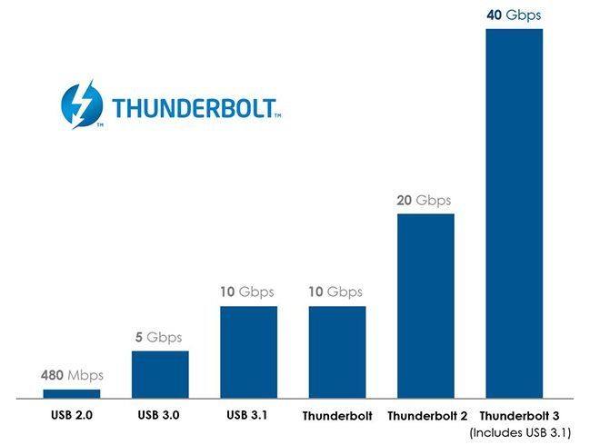

Thunderbolt 3 spec announced with support for USB-C connector, transfer speeds of up to 40Gbps

The next generation of the high-speed Thunderbolt specification was announced on Tuesday, ditching the legacy Mini DisplayPort connector for the new smaller, reversible USB-C standard, and offering transfer speeds of up to 40Gbps with high-end cables.
Thunderbolt 3 will be a "superset" for USB 3.1, which runs at 10Gbps. Using a standard USB-C cable, Thunderbolt 3 will offer transfer speeds of twice that, at 20Gbps.
Users who buy an active copper USB-C cable will gain access to 40Gbps transfer speeds with Thunderbolt 3. And optical cables supporting the new standard will offer that same speed over greater distances when they hit the market next year.
Because Thunderbolt 3 is compliant with the USB-C standard and USB 3.1 specification, the cabling will also simultaneously support DisplayPort 1.2, third-generation PCI Express, and power supply for recharging notebooks at up to 100 watts.

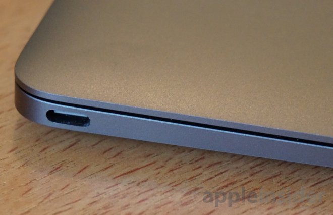

Apple was among the first to adopt the new USB-C connector with its all-new 12-inch MacBook, featuring a single USB-C port for both charging and connecting devices. USB-C is reversible, like Apple's proprietary Lightning connector, but the open standard is expected to be adopted by most forthcoming PCs and will not be limited to Apple hardware.
The USB-C connector on Apple's current MacBook. Future hardware will support Thunderbolt 3 in addition to USB 3.1.
