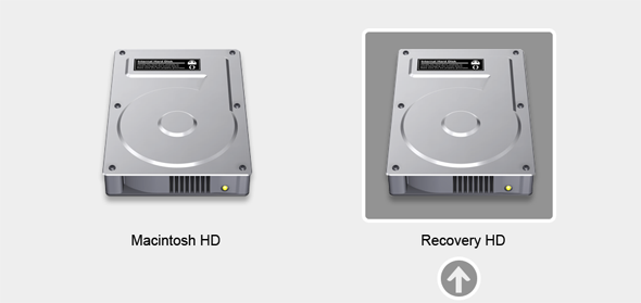

Restart or start up your Mac while holding down the Option key; keep holding Option until the Startup Manager—a gray screen showing all connected, bootable volume appears. One of the volumes will be Macintosh HD, click that and tell us what happens.
Try this:
1. Power off the MacBook
2. Hold Option key and press the power button
3. Continue holding down Option key...It should boot to the following screen:
4. Click on Macintosh HD
5. It should startup normally
If it doesn't, or you don't get this screen, let us know and we'll go from there.
